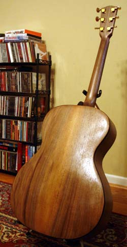

[QUOTE=Kristopher10] I believe that some Aussies are actually carving their backs which means no braces... Very heavy, but good projection. [/QUOTE]
This one wasn't too heavy...
It's a slip matched black walnut back without any bracing. It's about 1/4" thick at it's thinnest point and about 3/8" at it's thickest. I'm pretty happy with the sound...I'm doing a mahogany version right now.
